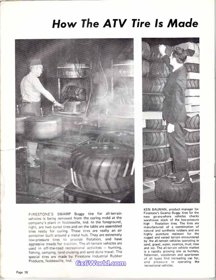

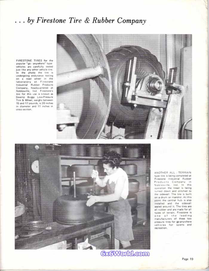

Here is an article titled "How the ATV tire is made". It outlines some of Firestone Tire and Rubber Company's processes for manufacturing ATV balloon tires.
