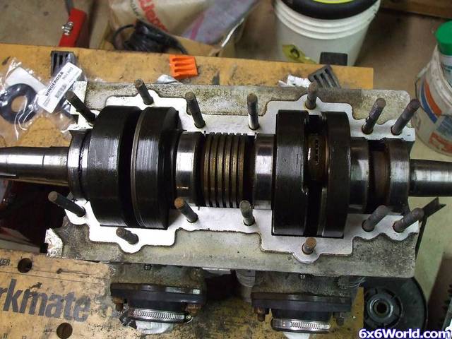

      High performance engine design with bottom end that fills the crankcase and has no internal case seals. Not sure what the contamination is in the case. It does not appear to be rust but crusty varnish from fuel.
