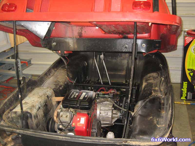

Unbolt the upper body from the tub. If you have a stock Max II you just have to unbolt the wingnuts. You do not have to remove the ones at the very front of the 6x6. They will hold the tub in place while you pivot it up from the rear.
If your Max is equipped with seat belts then you will also have to remove the spring clips under the seat.
Lift the body from the rear and prop it up.
