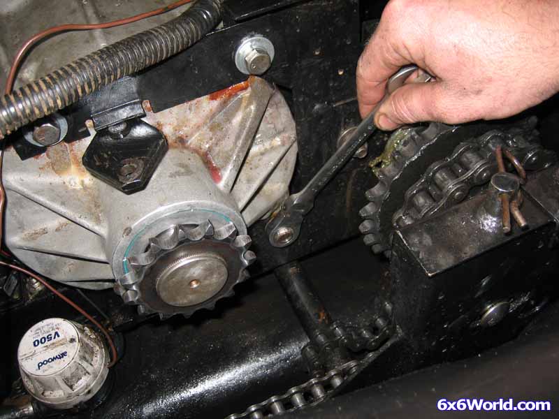

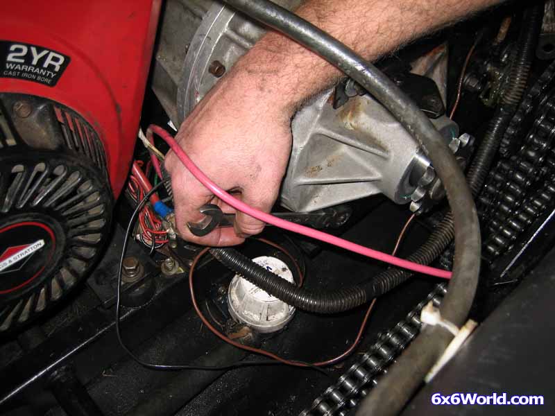

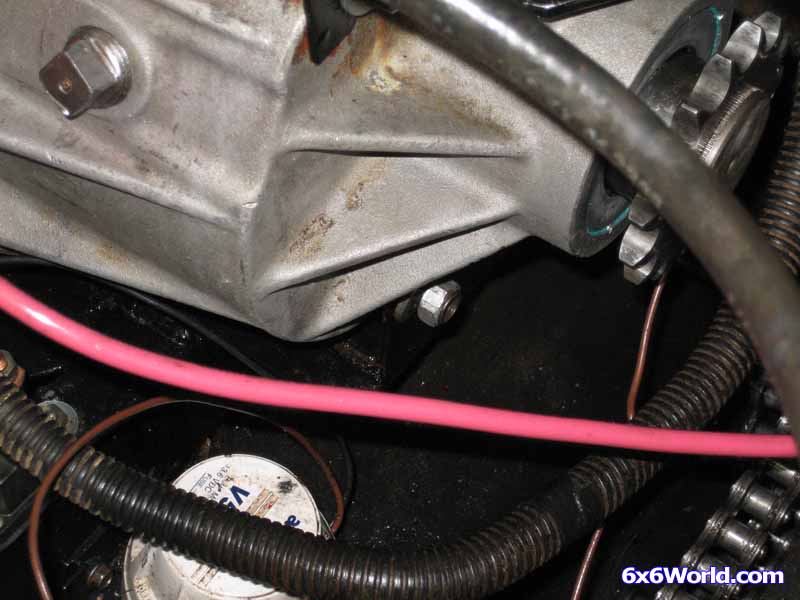

Place the T20 back in the frame. Slide the rear bolts in the slots first and then tilt the transmission down so that the front two bolts slide in the front slots.

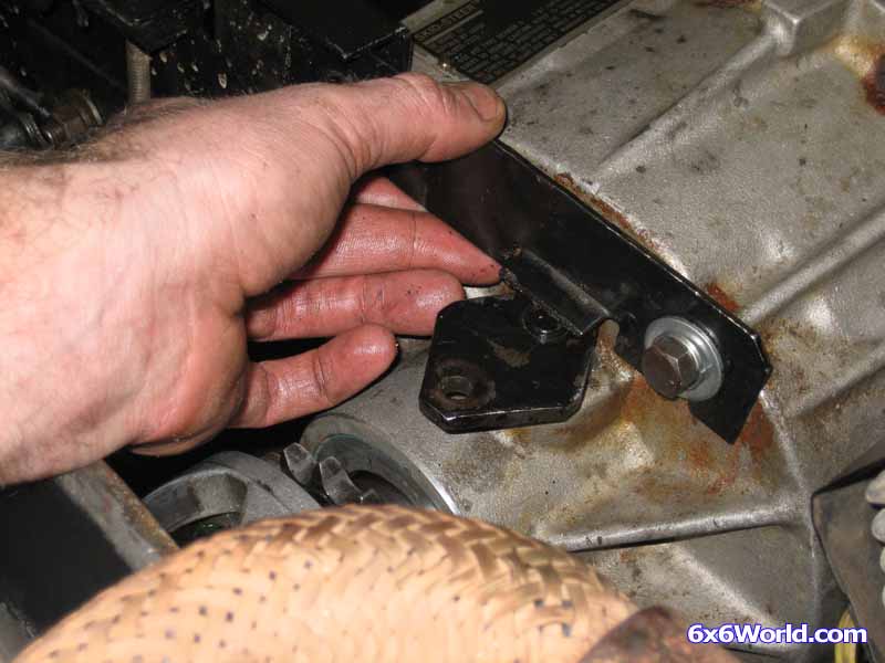

Slide the shifter retainer plate back into position but do not tighten yet.
Tighten the bottom four bolts on the T20.

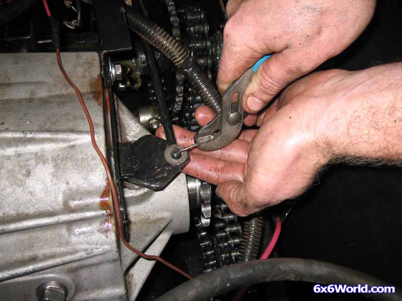

Replace the shifter rods and insert the cotter pins. Press the shifter retainer plate down and tighten the top two bolts on both sides.
