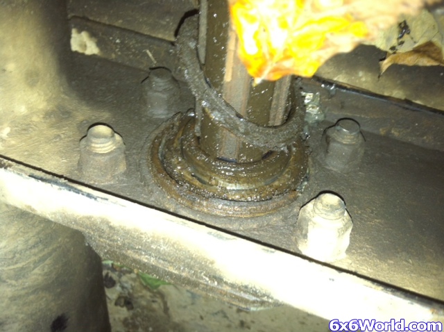

    This is my problem, rear axle, left side on the frame.
    What broke?
    Thanks!
    The bearing.. You will need a new bearing and cork bearing gasket. Simple enough to replace.

      Search for "inner bearing". There are cheaper ways to get these than from a dealer.
      [Edit #1]
      hmm. Or maybe 8 or 10a. Your picture is kinda wonky.
      [Edit #2]
      10a
      Okay, take it apart and lay the parts out.
        Whoops I was thinking it was outer.. but its is an inner.. You need a UCX05-16 bearing.. about $10 at Buffalo Bearing 1-800-669-8019. There is an inner bearing gasket, just clean and reuse. Or you can make a new one from the cardboard box of a 12-pack adult beverage of your choice. Or you can just toss it out altogether.. I made new.. was a good excuse to buy "Argo Parts".

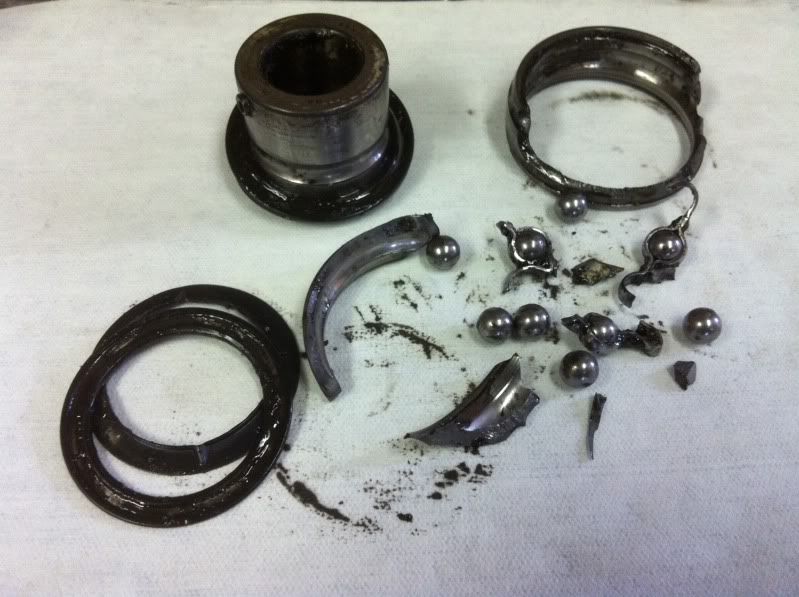

                      Found this on one of RD's threads:
                      The parts look similar to what I found in the tub. I didn't find any of the balls from inside but I didn't look hard either. Is the bearing all that needs replacement? If so, is that anything a local store will keep in stock? Or an online order only?
                      Thanks yall
                      Edit: Actually, I haven't even seen the main piece in the top center of RD's pic. I saw the piece on the top right of RD's pic. I guess I just need to look harder.

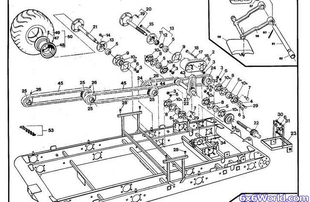

                          Thanks for the response trev! I am sitting her scratching my head over the d*mn Argo parts manual related to this stuff. (Page 1 of this thread, first post I believe has the image) There are so many parts in that diagram. I can't decide what actually broke! Can you point me in the right direction?

                              Search the site for axle bearings. I know there have been many recommendations for sourcing them.
                              I see it. It's still on the end of the axle.

                              I can only go by what I see so I am going to assume the outer bearing is good. You'll have to make the determination.
                              Let's reference the parts diagram that you posted. You can see that it only show two of the axles, an inner and outer.
                              Follow the line that comes off of the end of the axle and follow as it passes through the parts. You will concentrate on everything past the sprocket (24) to the thrust bolt (29) that threads into the end.
                              The thrust bolt (I hope that is what it is called, I am not looking this up) and thrust washers (4) look fine in your picture.
                              Nuts, bolts, washers (3, 7, 6) are probably fine.
                              The inboard flange (10b) looks toasted. I would get flanges (10a and 10b), gasket (8), and new bearing (5a). 10a might be okay but I erred on replacing in this instance even though I said I would comment on only what I can see.
                              Gee, you and Trevor had a whole conversation while I typed that up...
