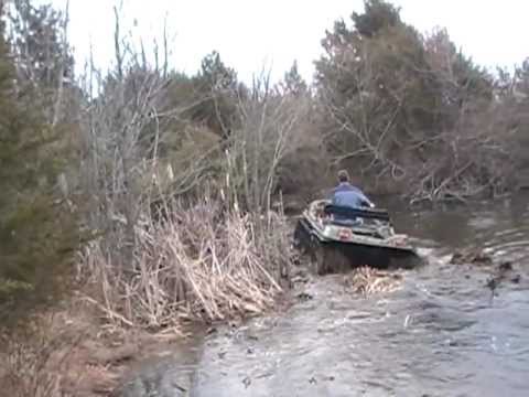

            The Adair tracks are the way to go. Here's a video of me in a pond just after installing them on an Avenger:
