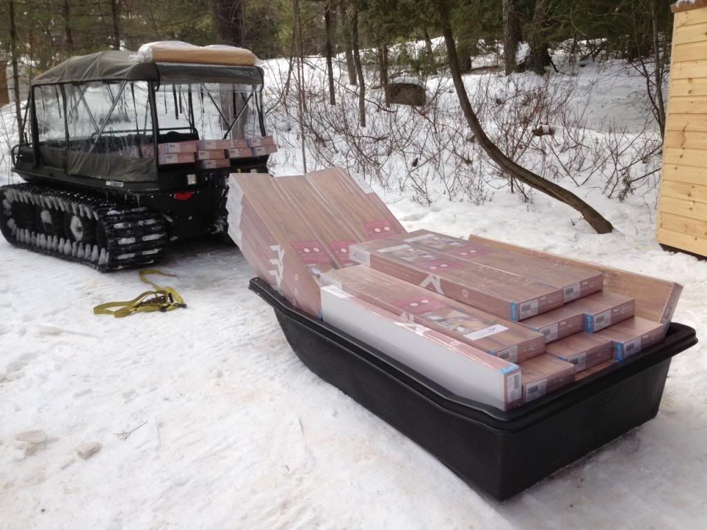

              This machine blows me away with the pulling power it has....
              This is over 2000lbs of flooring that we pulled across a lake for five miles covered in 12 inches of slush......simply amazing!!!!

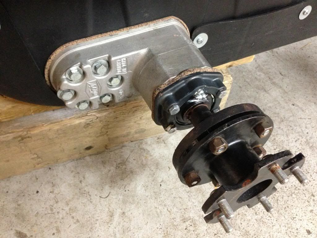

                  Last week I broke an axle flange on the old Argo. The early style stamped steel flange is not up to the task.
                  I ordered all the parts to convert to the HD setup like on the new machines ( only on the front and rear ) The HD axles are a much hevier design with a 1/2 inch thick flange .....way stronger. I also converted to the HD bearing upgrade. Everyone has been telling me to use track tuners....so I will give them a try.

                    The HD upgrade was a very straight forward install. The only thing I changed was to install 90 deg. grease nipples to make greasing easier with tracks on.
                    The Adair track tuners are 2 3/4" and the Bolduc axle spacers are 2 1/2" ..... so adair supplied me with 1/4" spacers....great guys to deal with.

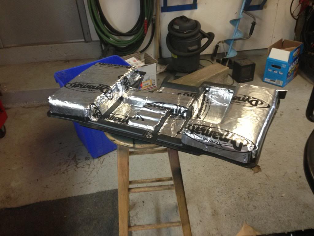

                        I had some Dynamat left over so I put some behind the engine cover in hopes of making the ride a little quiter.
                        It made a big difference....much better than expected

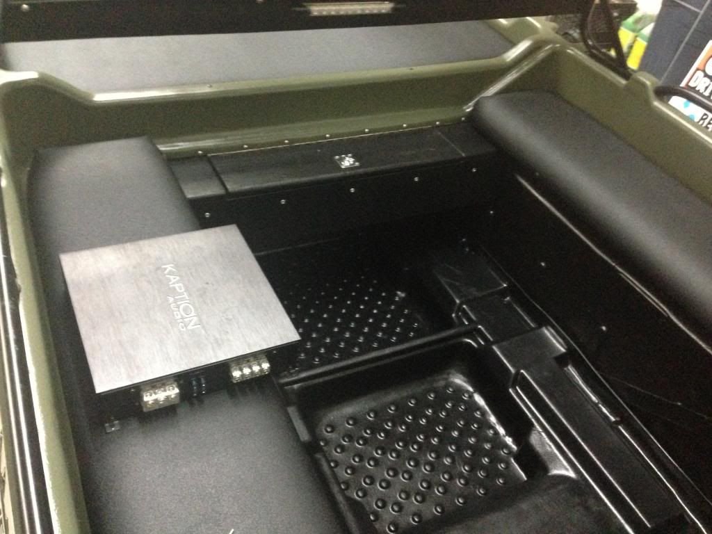

                              Also on the list is to upgrade the sound system.... adding two speakers, a powered subwofer and a 300 watt amp should get her rockin. Also want to spend some time to lower engine and transmision noise..... I have a few ideas.
