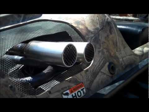

      I have a 2011 Argo Frontier and my friend has a 2008 Argo Frontier and we both had really bad heat issues running in temps in the 80's. We finally ended up running with out our hoods on, and this solved the heat problems. I didn't like riding with my hood off because pine needles, leaves, twigs would fall down into the engine compartment. The factor muffler is really restrictive, so I payed a friend to fabricate a custom exhaust for me. I also removed the stock air cleaner assembly and fabricated a cool air intake with a K&N air filter on the end. This made my exhaust sound deeper and made my engine run a lot cooler too. Another thing I did that REALLY helped with the heat issues was installing much liighter clutch weights. This makes the clutches engage at a higher rpm, pull more air into the engine, making the hp and torgue come on sooner too. When I twist the throttle now my 23 hp engine feels more like a 27 hp engine.
