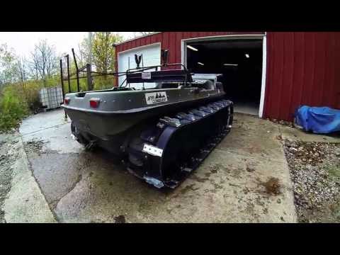

Well I did manage to get the tracks on today. Bad news is they have to come off. They are rubbing very bad on the bottom of the tub. And snagged my skid plate and ripped it. Was supposed to come with spacers but I didn't get any. Mike is sending me some out today. He also informed me that I have to trim them back due to them being to big. That's my only option. So I will have to get it back in the shop, pull the tracks off, pull the wheels off and look at the skid plate and hope its not that bad. Anyway I did manage to get some video. Here is a pick of them on. I did have to take the winter kit off. Its just way to aggressive for the kind of riding I do day to day. But I will not have to worry about ice come winter. These things will chew right thru it. If the tracks don't chew up my machine first.

Don't get me wrong, I'm not knocking the tracks at all. This is my first experience with tracks. And I didn't realize the adjustments and all. But yea I'm not worried at all, I know Tim and Mike will get me all squared away. Just frustrating. All that said, I did get some video edited. Hurried thru the sound stitching so please excuse that. I was in a hurry and it seems to take me for ever to do video.Originally posted by Bspears View PostSorry to hear that, one thing for sure your dealing with a great bunch of people, I'm sure they will help you any way they can! I just ordered my third set and have not had a problem. Good luck wish I could help
Thanks Doc! Yea they squeal something awful on concrete . They are no joke. I couldn't imagine them gripping so well. And sharp too. Cut me up a little when I took them off. But they roll up nice and fit perfect on the bottom shelf of my work bench.Originally posted by Rock Doctor View PostLol, loved it.

It's super easy to put tracks on if you take a shop vac and suck the air out of the first and last tire. Just don't suck tire off bead! You don't need any attachment just put open hose of vac over valve stem once sucked down put valve stem cap back on
