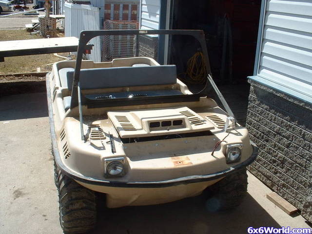

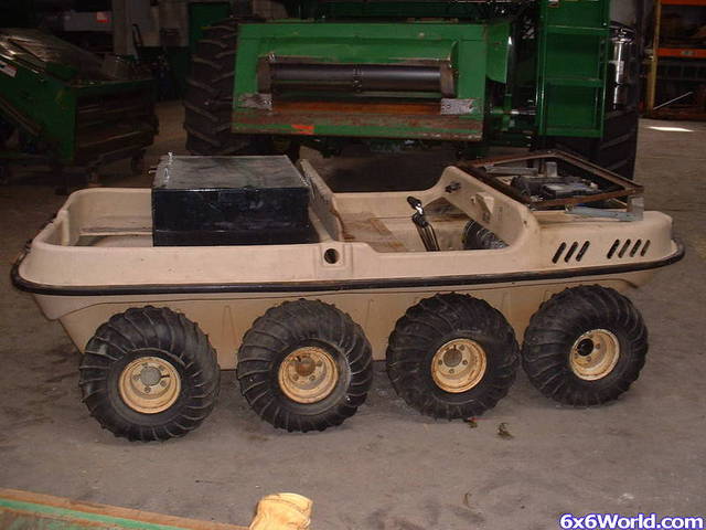

                rod this should be it's twin less the engine and windshield.
                  And this was the hood I suspected you to have.
                    Yep, that's the one Jim, checked today. It's serial number HTB 6972 any idea on year? Knocked all the axle pins out today (the son that is, not me) all came out easy. Need to knock a puller up now to remove all axles. just looking at different ideas for one. Got a trade account at local suppliers so probably going with a new 20t hydraulic jack that only cost a few £ and make a dedicated axle puller (it'll be needed again for sure).
