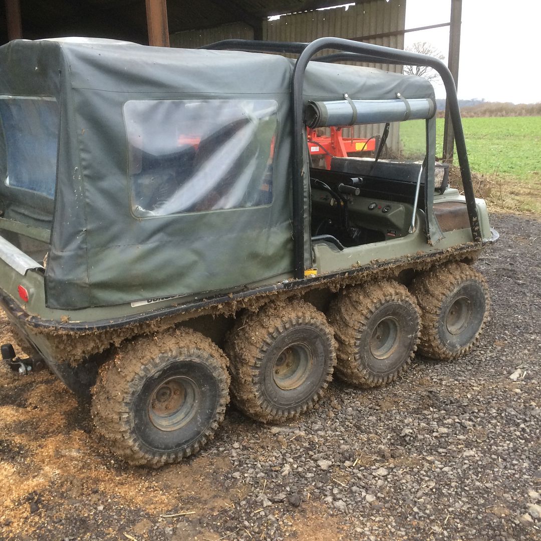

First post on here so go easy with me!! I have a 1997 conquest, when driving in high range at speed when I come to make a turn my machine bogs down to almost a stop, when I release the brake lever she's off like a rocket has loads of power in straight and up hills loaded and unloaded, but bogs down really bad when turn after going at speed in high, clutches work as they should at in neutral but very hard to check on your own at speed under load. I spoke to an Argo place here in the uk today and has told me a list of thingd to check. Just wanted to know if anyone had this issue before? It's fine in low and when going slow no tracks fitted recent chains and bearings tyres are 5psi any help would be great

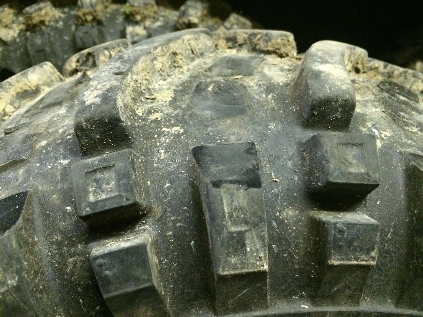

First thing seen is the tires have side bite (harder to turn), hear some slapping that is probably normal chain tensioner noise, clutches look to be doing there thing.
