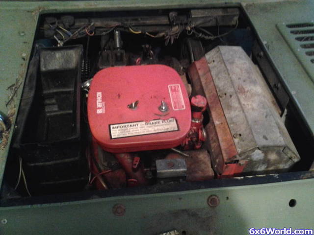

    my air cooled magnum overheats alot. i was hoping to find a cheap and easy way to troubleshoot this before the spring when i unleash the beast.!
    Does you machine have this black duct in it?
      yes it does why?
        It greatly helps with cool air into engine, are you running with the windshield down?
          most of the times no. so not alot

                        Helo Curtis, I owned a magnum for 10 years. they are great machines. As for your overheating issue, RapidRoy is spot on. Process of elimination is the key. One thing you could check is the color of your spark plugs to see if the fuel mixture is lean. a lean mixture will cause more heat in the combustion chamber. your spark plugs electrode should be a chocolate color. if the electrode is whitish, this could indicate a lean mixture. next is to ensure that all the shrouds/ducts in the engine compartment are secure and in place. this prevents the cooling fan from drawing in hot air from the engine compartment. Gaps in the exhaust shrouds could cause hot air to be pushed into the engine compartment. One easy thing to check is the screen on the cooling fan intake. This is located at the bottom of the black duct on the right hand side of the engine compartment. this screen can get plugged with twigs, and other junk. My 90 magnum had allot of oily dirt built up in the cooling fins of the motor. This could also be a possibility. Hope this helps and good luck
