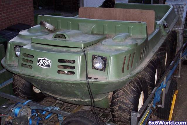

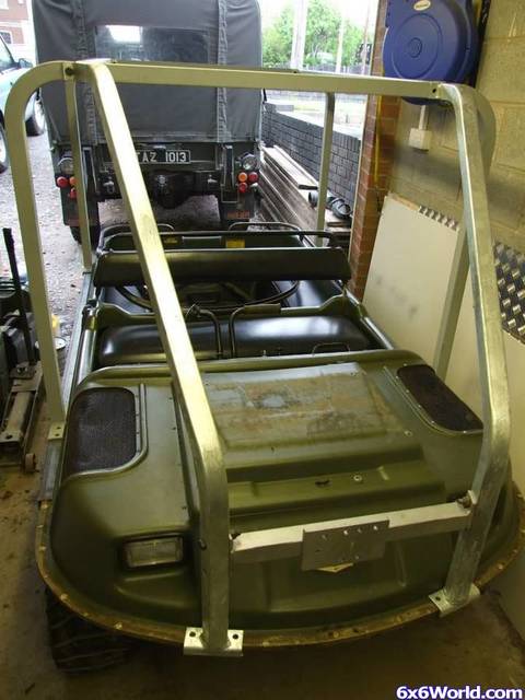

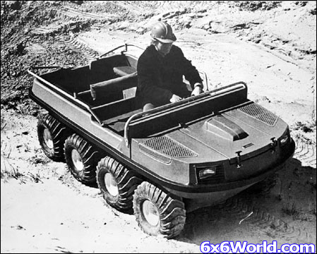

                          Looking at this picture, may have been a rebodyed HTB , with the center hood bump for the Tecumseh.
