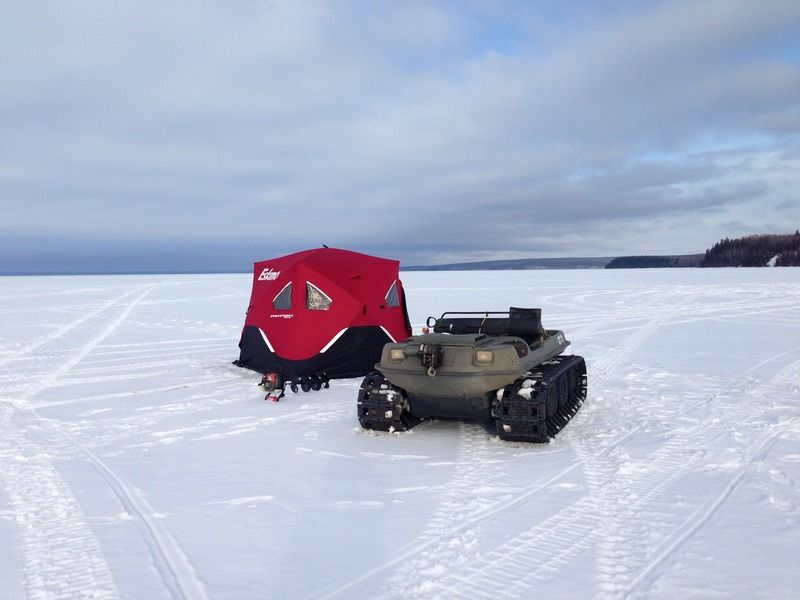

                The ironically named conquest has pretty much taken over my life now, wife has been complaining that we never do anything. I thought back and realised I've spent pretty much all of my spare time over the past 6 weeks working on this machine lol. She's right, so I took her fishing this weekend - with the argo lol.

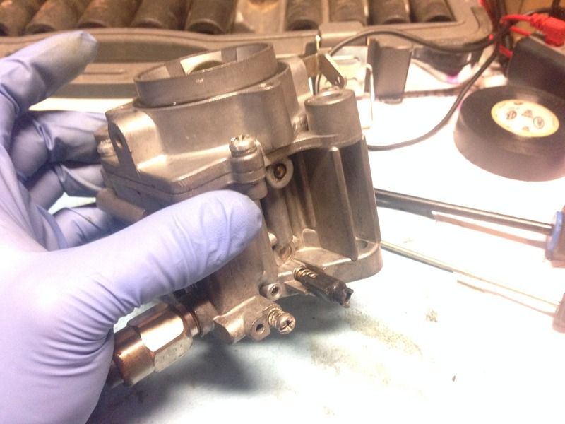

                              Cleaned carb again with ultrasonic cleaner, working much better now. Idle is way up now and won't shift. Anyone know which screw is which?
                              Which one is the one you turn all the way in then 1 3/4 turns out? The one on the right has a black plastic piece over it and it can only turn 1/4 turn CCW or CW. What the heck is that about? I can't make any sense of the manual, all of the pictures are crap.
