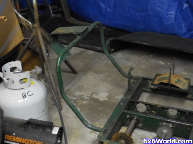

      Any build plans or videos you guys come up with I would love to see.
      • #18
        Thanks for the pic ARGOJIM. This will give me a good template to work off of.
        Thanks
        • #19
          The winch plate is welded to the angle iron belly band. The back 2 holes go through the body and are attached to another piece of angle iron that is up against the body band on the inside.
