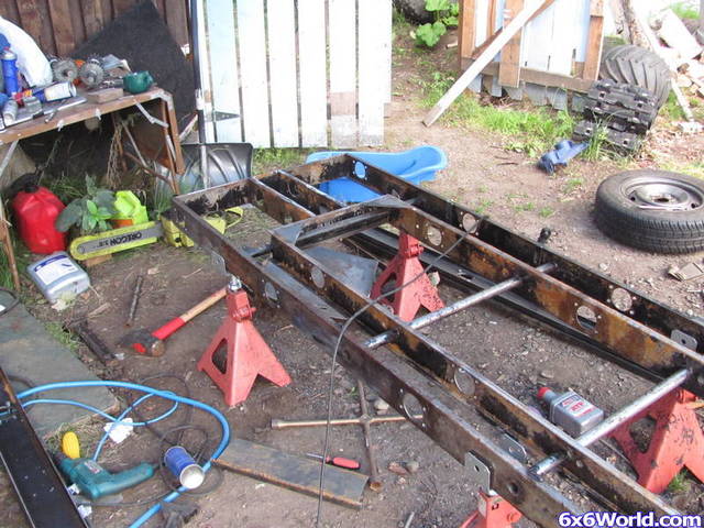

Here is a picture of Spookum's machine prior to major beefing, looks to be about stock.

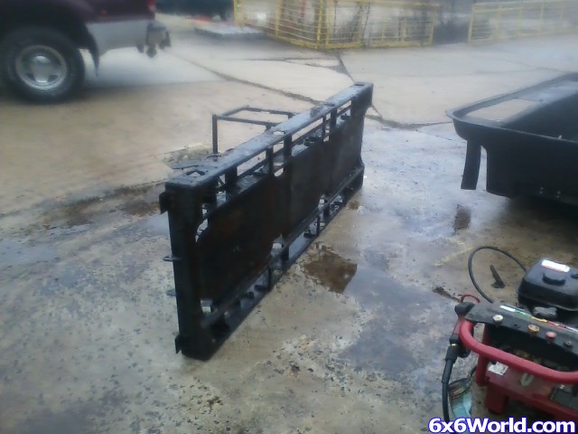

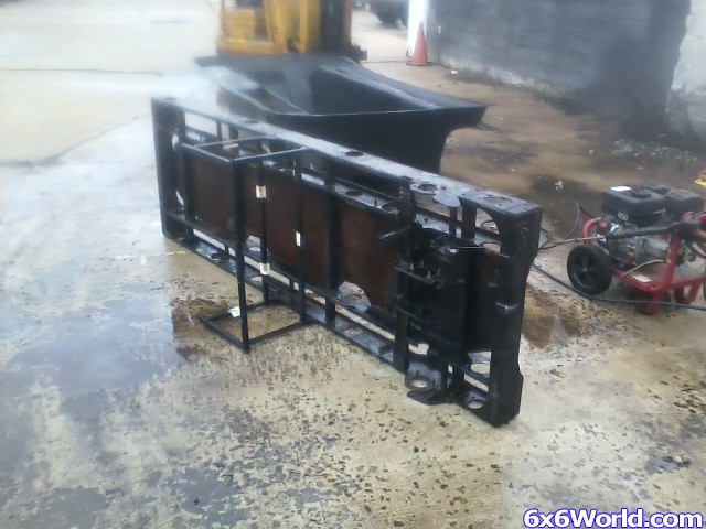

Here is a 2007 Avenger frame, many of the belly pan welds were actually rusted thin or detached, no other weld or frame cracks.
