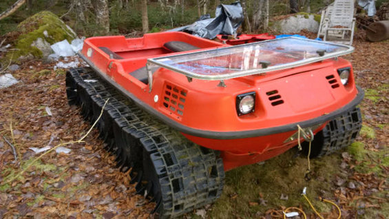

I found one about 1.5 hours away. Seller couldnt tell me much, all i had to go on was pictures:
It turned out to be an 86 conquest. 18hp Kohler Magnum, splined axles, fluid brakes, couple bilge pumps, windshield with wipers, supertracks and a cloth top. It was used, but not what i would say was abused. And it was (mostly) all there and intact.
He was asking $4500 CAD in the ad. When we were talking over the phone I told him I was looking for something in the 3000-3500 CAD range. He said he'd take 3500 so we were a go for a starting point at least.
I got there and it had knobby tires (kenda 20" dominators) inside the tracks instead of run a mucks. Tires were fairly new. The tracks were loose as heck. No rear floor pan. Ran like poop, but it had been sitting since last winter (he had bought a newer one) so liley the carb was gumm d up, had some water in the bowl and the gas was turning bad . It was hard as hell to drive. Surging, low power and just generally unsteerable off and on. She metim s it wpild turn,
