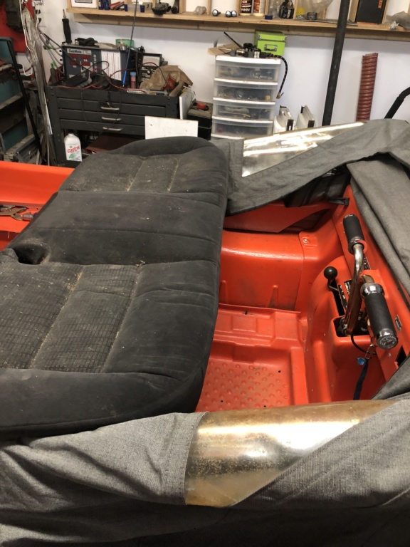

                            Seats are finished to the "rough in" stage:
                            Took it out for a burn and the seats do their job well! Almost all of the banging and jarring is gone out of the ride.
                            I opened it up and got to max speed whipping across uneven ground. I hit a big hole (hidden under the snow) and unintentionally got some fairly serious air (at least it was for an Argo! LOL!). Now I'm not going to say it was fun, but where it would have hurt me quite a lot before, now it was just a big bounce and merely uncomfortable to be tossed.
                            You do sit a fair bit higher than before and You're best to stay off the center raised portion of the seat, but it's 10x better than it used to be.
                            I'll just make the sticks a little taller and slide them to the RH side a little more and it will be near bang on.
