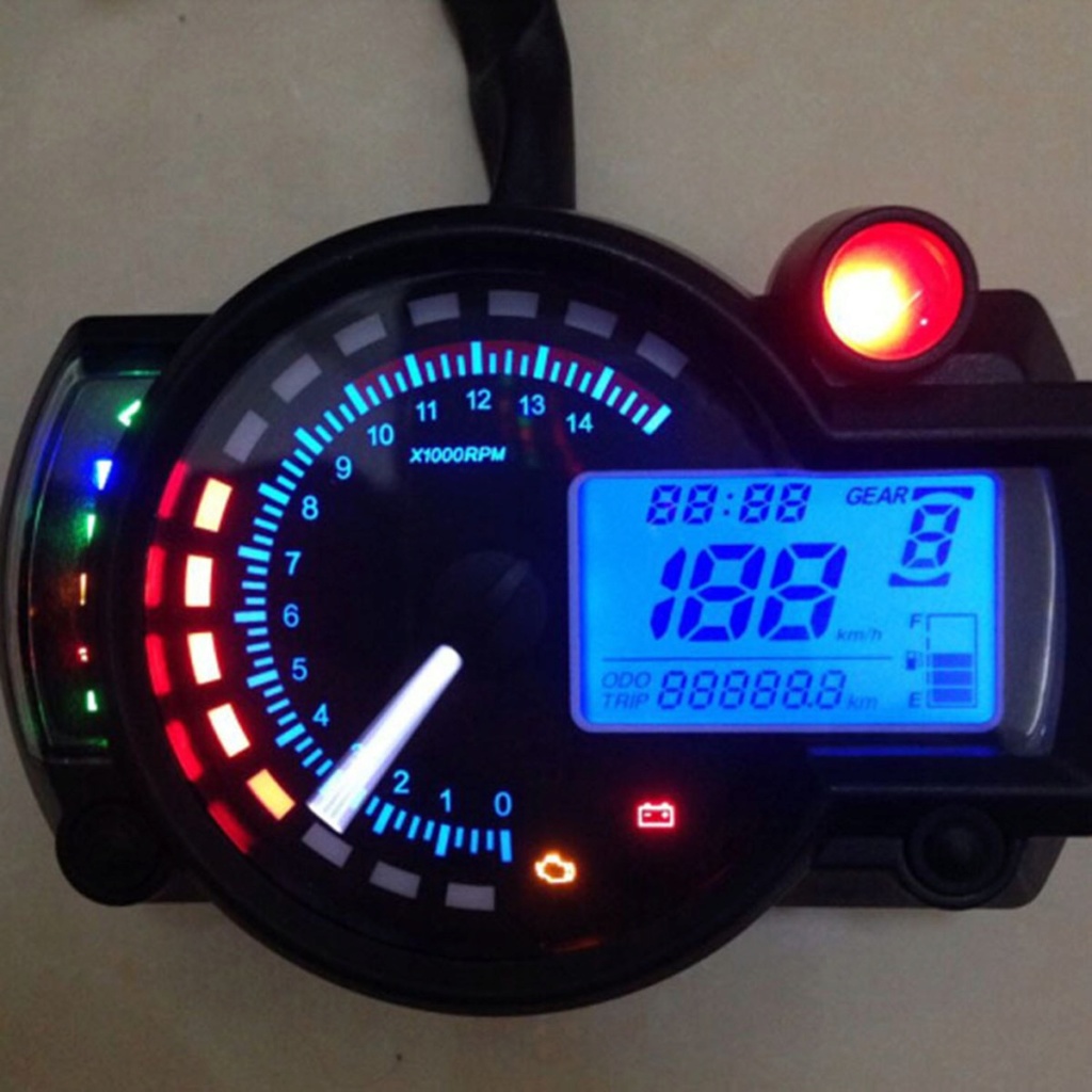

I’m “in progress” with a fuel guage. It’s incorporated into this:
which is going into my dash “redesign” on my 87 I/C.
The rest is just figuring out what resistance values it’s looking for and adding the approriate sender unit. They’re all pretty much the same when it comes to how they operate.
Sender has a float on a rod that moves a “wiper” on a coil which sends a resistance to the gauge, which interprets that value as a certain fuel level and displays it on the gauge. Whether the gauge is digital or analog makes no difference as that is internal to the gauge.
