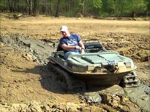

                    The is an Argo Bigfoot with with 22" tires and Adair tracks-Mike driving:

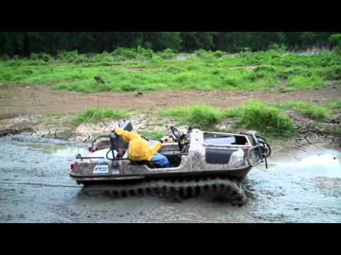

                    Noel Woods at River run:
