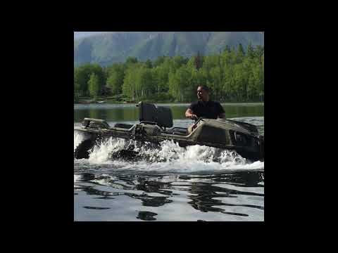

        swim video uploading to youtube now. Will post shortly. I played around with the throttle a bit, I think 1/2 to 2/3 throttle ideal. Anyway you’ll see me messing around with throttle and occasionally stopping track altogether on one side. Also, there is no reduction of machine’s top speed with half tracks as compared to stock tires only. And no track tuners required for elevated belt Bush Tracks. 1.5” UV stabilized UHMW grousers, made in the USA 4-ply 4x1 belting. Full thickness grade-8 through bolts, Unwearable/unbreakable hinge. Run Flat design, easy on/off machine. 22-1/2” wide, 68lb dry weight. I should probably have this on a different thread?
        • #34
          Alaska Bush Tracks
          AK Bushbuster Half-Track swimming video
          Not an adair track, maybe it should be a separate thread?

            first of all buzz ...what gorgeous country . i loved seeing those little patches of snow up on the high mnts. the tracks looked like they swam really well and they look cool on the middle tires . climbed right out of the lake and up the steep bank with no problem . with the way my half tracks perform on my max 2 , i see no reason to run full ones again . thanks for posting . if i'm ever up that way i will stop by . johnboy va.
            • #36
              Buzz thanks for sharing, I have wanted to see your half track system every since you talked about it. As for your machine, the half track seems to be a good compromise between swim speed and mobility. As far as swim speed, that machine is very fast for a semi tracked machine and I applaud your efforts in making something that is already very good better. I would be afraid of clearance issues with the half track design but I never heard them pop the while you turning those tracks at a very good speed in the water.

                  I gotta edit some Swamp/mud holes footage of the half tracks out in Petersville. They did great. I’ll mount some paddles to a full track (aurora 8x8) and drop it in the lake for all to see very soon. It’s next on the docket. A conquest starter swap called today and I had to service my machine as well. Fyi, you can just roll the belt right off the aurora/avenger clutches if you need to swap, although it is nice to have the argo t-handle tool ($5-10?) or use a valve cover bolt you mentioned (easier on the finger tips).

                    Great videos Buzz. Really like the half tracks
