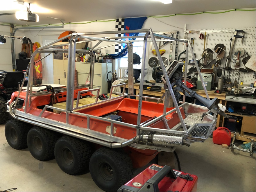

I mount a 2hp Johnson on mine and use that if doing any serious water traversing.
Deployed:
Land travel:
Not much sense going any bigger. Just ads weight and no real increase in water speed. The Argo is a displacement hull design and has those eight "drag inducing" wheels sticking out too. It's only ever going to go so fast. About 2 mph or so is the most that can be expected. Somewhere around 1-2 mph with tire drive, but the outboard deals with currents and wind much better.
