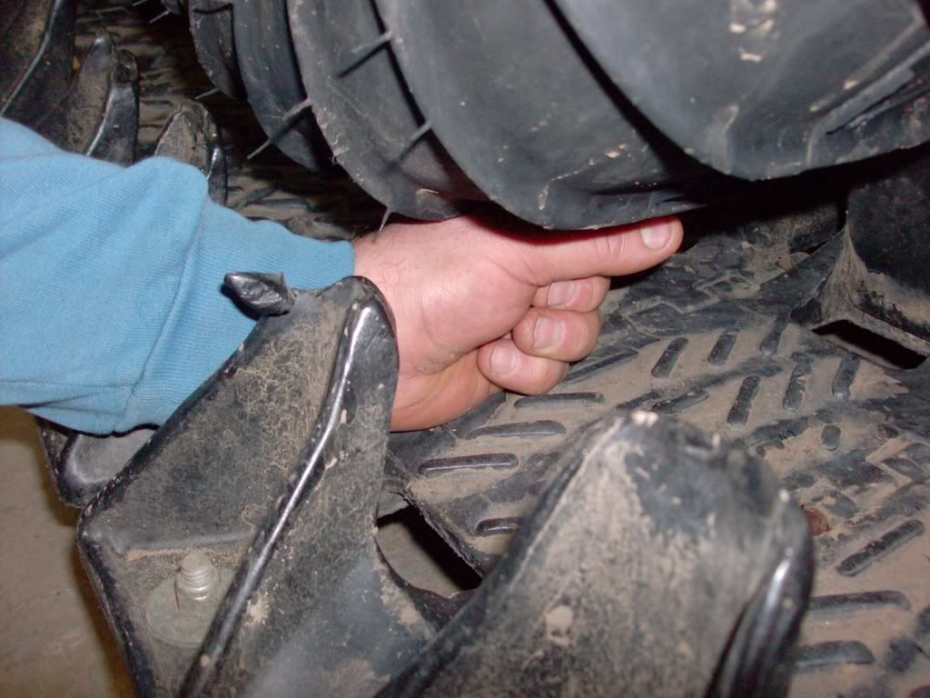

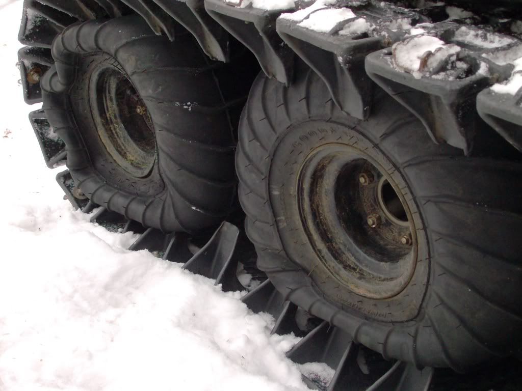

Hello everyone, we got a lot of snow here so i decide to put up my 18" supertracks. Last summer i bought some brand new 22-11-8 goodyear runamuk to replace my farely used 20-11-8 original rumamuk( the 20" were so used that they are taller than my brand new 22") . My problem is that my tracks have some problem fitting in on my new tires... Track keep slapping on my undercarriage while riding in the snow. I think they are too loose... I can put my hand closed between the tracks and the tire without any problem. Got some half-link that i can put on but i was wondering if i got the good amount of track section for my rig( 28 sections). I have a 1985 Argo Vanguard with 24" between each wheels and 48" between the first and the last in the back. I post some pics to show how it is... Can anyone help me on that

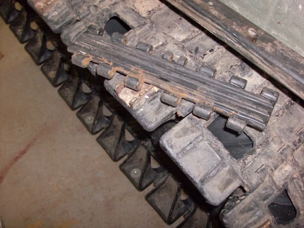

. Tracks were off the tire in the inside. Back it up on the ground, removed tracks and put them back on and put 4psi of air in tires. Went in the trail to try it. 15min later my left track went off my wheels completely and the other side was over the tire!!! What a mess
