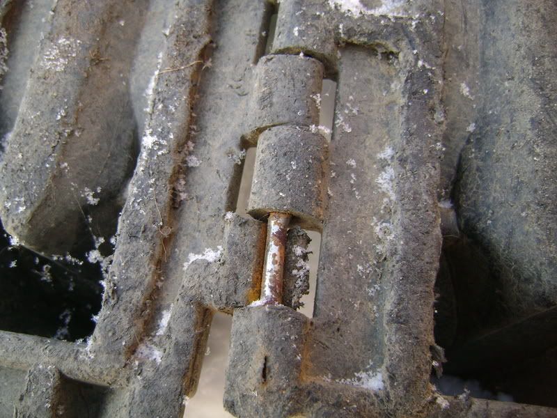

So, how many of you guys have abused your plastic tracks enough that you have had to replace segments? I try to keep track use to a minimum in the summer, but still find myself rumbling through rocks/gravel/sand/silt/ice, ect in places that I don't want to be. (This is not much of a problem anymore since I switched to 24" Frontier Tires, I'm too lazy to swap tires just to put the tracks on
) With the variable terrain that I run, I could spend hours crunching through sharp rocks, mixed with super gooey swamp/muskeg.
I have thought about pulling the tracks off in the rough stuff, and then putting them back on when needed. I can get them off in about 5 min, and back on in about 15-20 min, but that can be alot of off's and on's in a day sometimes
. And then I would have to find a place to haul them, wouldn't be bad if I was running empty, but I'm never running empty
I will still put the tracks on in the summer, if I'm sure I will need them, but only for certian trails.
Had to dig them out of the snow to show you, and some have been sitting outside for a while (Kinda rusty now)

, I think I will stick with the old way. I can have my tracks on and ready to roll in about 10min. I roll out the tracks in front of the Argo, Drive on, Pull front and rear tire valve stems, Pull the track ends togeather by hand, Install pin and setscrew, Put valve stems back in and inflate tires. DONE
