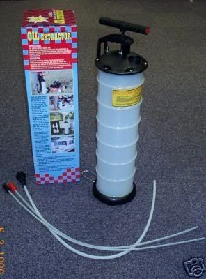

                  here ya go
                  bought this after having it recommended by our dealer here in Anchorage. Couple pumps, the thing sucked all the oil out in less than 5 minutes with no mess whatsoever. stick the tube down the dipstick hole and you're in business. Carquest sells these here in Anchorage so imagine if you have a local Carquest, you could obtain from there. If we can get it in Anchorage, you should have no problems elsewhere.
