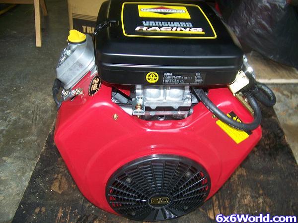

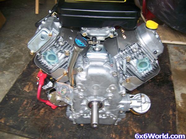

      I've changed several argo engines. One thing to look for is a motor
      thatis easy to work on in that small box. This fall I installed a20hp
      honda in an older 8x8 It out pulls my buddys 24hp kaw. but I'll have
      to pull the engine for any axle or engine work. Or you could do some
      performance work to existing motor
        First what size is the engine in you machine(HP). 600 racing sells a bandolero engine that is a 20 hp bumped up to a 30 HP. This engine has no governors and will really boost your HP. The engine is actually cheaper than a factory 20 hp or 18 HP. I am pretty sure the 20 has the same footprint as the 18 HP. They are not water cooled.
        These engines are fast, and should fit the machine. May need to get high speed clutches. I am not sure if this is what you are looking for but thought i would let you know that you have a few options.
        You can go to the Briggs site and check the dimensions of the motors and get a better idea if it will fit.

          I think all 14 thru 20 will be the same dimensions externally. I bet the 23 block is the same externally, the heads are just a little taller, and the exhaust on a 14/20 won't bolt up to a 23.
          I've been reading about Kawasaki's, very interesting stuff. Some engine groups vary by maybe 5 HP, the only difference being compression, carbs, carb jetting and or limiting throttle plate opening. All the same displacement.

                          HP is good for the slow, rough stuff, too. Let's say you're at the bottom of a steep but not too long incline with that moose. A stock governed 18 vanguard makes it up 1/2 way before slowing and spinning wheels. Adjust the governor and clutches so it will turn 4000, and it makes it a little farther before rpms fall back because it still is making the same power, you just got the flywheel spinning a little more on the take off. Now, a vanguard with 30 hp pulls off at 4000, and stays there as you top the incline with the front 6 wheels in the air
                          Yes, you'll be replacing chain more often. And the whole machine in general needs to be strong and in good shape. But to some of us it's worth it.
