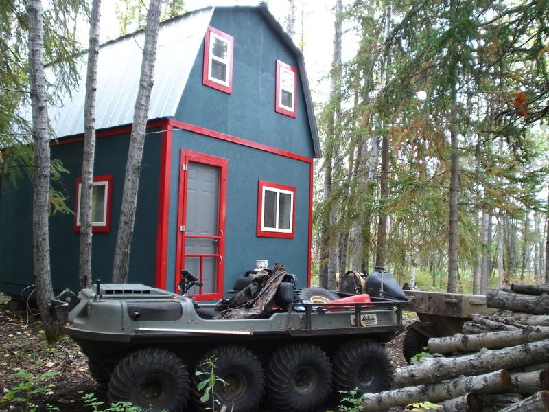

        Here's one:
        Here's mine:
        They are a tight fit though:
        Real tight:
        Actually one friend had to take a couple back and exchange them for a couple different ones. Quality Control could be better, as I have seen up to almost 3" difference in circumference between tires at the same pressure.

                    I was trying different araingments. Some guys found that having the front tires mounted backwards helped them climb out of holes better, so I tried it. Didn't work out for my riding conditions, but I did find that having the 3rd tires backwards does help out when swimming in reverse.
                    There was a thread wher this was discussed in detail, but I don't recall what it was called.

                        I have a 1979 Argo, running 3 hole hubs, but updated rims... I have 21s on it now, do you think the 24" Carsiles would fit???
                        Thanks
                        P.S. I attached 3 photos of it!
                          Sorry about the black lines on the Argos side view...
                            not to sure that they will fit on yours, my dad has a machine about the same age as yours, and has less room around the tires than my conquest does. but argo does sell the same tread in a 22x20x8 tire that will fit onto your machine with no problem.
                            hope this helps, Darin
