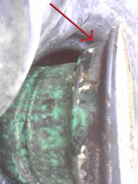

              This picture tells quite a story. Notice the copious amounts of expensive name brand tire sealing compound. Notice the tire...not seated. Notice the shape of the metal rim. (how can that hold a tire on?) Did I really spend all that time last year handbusting tires because Argo has a faulty rim design. The other side of the rim seats a bead nicely. I would take a picture, but the tire is still connected on that side. I have lots of these, like about 5.
              Will factory max wheels solve this. Unless I am just wrong, then Argo designed and sold a rim (granted, back in the day) that cannot hold a tire bead on in a rut at 5 psi...period.

                That certainly is a poorly designed rim and the only application that it should be used for is on a garden tractor or golf cart. If you get a set of Max K-Lock bead lock wheels (these are standard equipment on Maxes for the past 10 years or so) you will have no problem holding a bead on even at 1 PSI. I NEVER lost a bead on any of my Max K lock wheels and I run them on every different machine that I own. I heard there are even guys that run tires at 0 PSI without any issues. Call up Recreatives and order up some and you'll be happy that you did. Plus they have a nice deep glossy black powdercoated finish on them. www.maxatvs.com

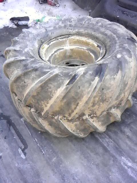

                  Here is a picture of the kind of tread left on my tires, I should be getting better performance. Maybe with the right rims I will!
                    Any of the good folks at Recreatives will be able to help you out. You'll want the 8" rims, that's correct. They'll be a world of difference!

                        Those old wheels of yours may not be argo wheels.. I don't know about that old of a model. Could be aftermarket golf cart, etc wheels. The argo wheels I've seen had beads on both sides. They're still not as good as max k lock wheels by any means. I have seen a few tires lose a bead off of 8" k locks, 22" rawhide III's and 22" super swampers. But they were used tires that had been mounted/ de mounted/lost a bead, etc a few times so the bead dia. was probably stretched. I think they would be good glue candidates.
                        Max and argo both made "regular" wheels with beads on both sides, then around 1998 Max used the improved K lock. So the old max wheels your friend has might not be k locks. But any wheel with beads will be better.
