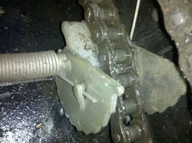

              Hi Vipercws, What year is your machine? I have a 2006 Avenger. You have a very good machine there. The chains are self adjusting and will ratchet up as the chains get slack. Argo made a change to the tensors from a coarse tooth to a fine tooth. Check to see if there is any debris or rust causing the tension assembly not to operate freely. Lube is recommended since it was sitting for 2 years they may have become stuck. If you can get a better picture of the claw it can be determined if you have the coarse or fine claw. The problem with the coarse is as the frame twists due to the terrain the coarse claws would make too big of a jump and when the machine leveled the chains would be way to tight. The fine threads take smaller jumps.
              Lube the tensors well and if need take the chain loose and clean out and grease the assembly and channel that they operate in and they should work fine. Mostly watch for the chains in the front locations becoming to tight. If they become to tight they can be loosened to remove the tension.

                Thank you all for the help, I really appreciate it. By the way you are describing things I'm understanding how these work now. Thanks for that. -I'm pretty my Avenger is an '06. I attached an image of the adjuster.
                The short chains coming off of the idler drive that go to the front seem much tighter than any of the other chains. When I pull on them theres really no flexion, just the slightest bit. Are these the ones your saying shouldn't get too tight? If so, how can I loosen them if need be?

                        Don't make the mistake to think that taking out or adding full or half links will be the solution. Have the chains stretched beyond the amount the tensioners can take up?
                        Are the tensioners moving up and down freely? Sometimes the guides can become gummed up with old grease, oil and dirt.
                        Are the springs on the tensioners in good shape? Are the chains in good shape, with no stiff links? I know with my '07 the tensioners to the front tires have been removed, as per Argo, as they are not effective with tracks with the short chain. I don't believe they are installed on newer units.
