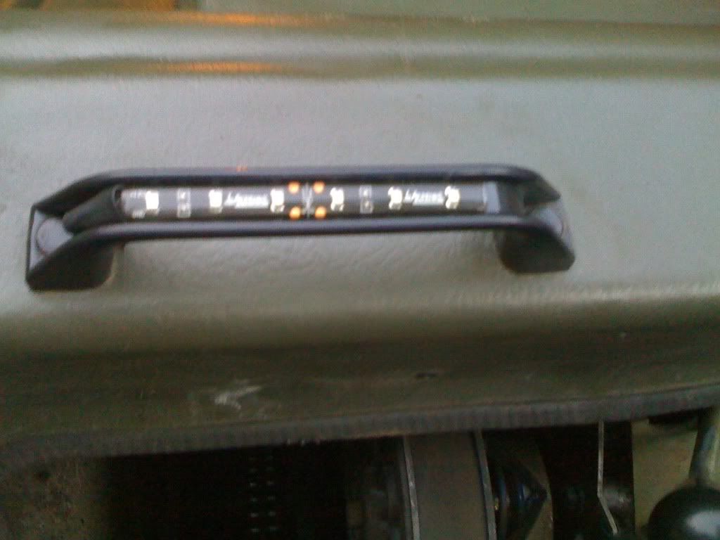

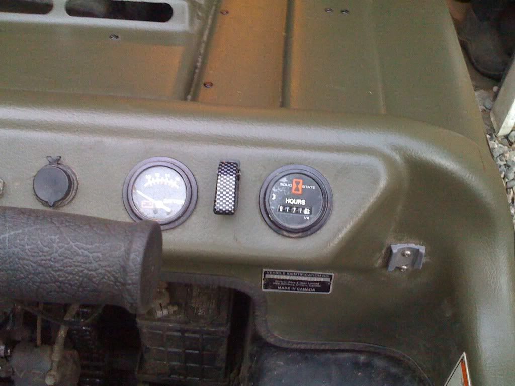

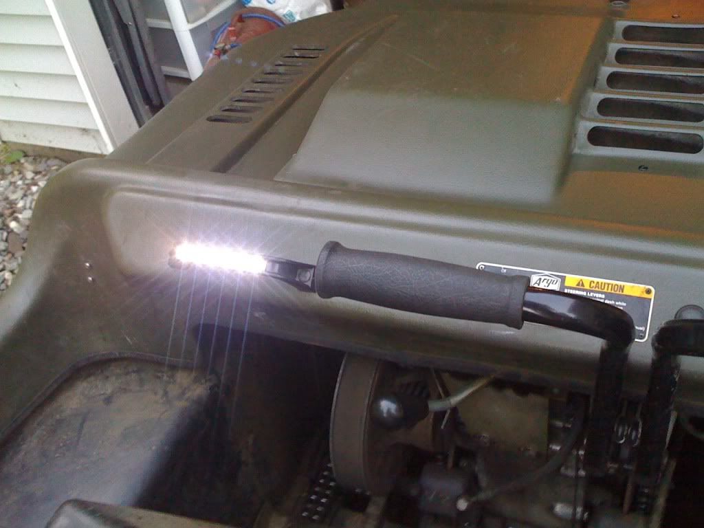

    Toggle switch with safety cover in off position
    Handle bar with switch in off position
    toggle in on position
    handle bar in on position
    So far my testing has made me very happy. I have not had any of the fuel starvation issues that i have dealt with since i bought this machine. I have found that it is more responsive after long periods of high load (the bowl is always full when the extra pump is running). There is also an extra filter installed before the pump to ensure long service
    What is the the light overkill? whats with this place, 50 views and no comments?
      looks cool bud,no problems with to much preasure?
        No issues with too much fuel. I even checked the air filter. I think that it just makes sure the bowl is almost full in the carb. As long as the needle has a good seat then there shouldnt be any issues with it running too rich right? Also i am not sure why but it seems as though the back fire at shut down is now gone...? will see if it stays that way, and dont know how to explain it if it is gone.

              i like the light. i prefer overkill on things like that. i'd rather have a blinding light letting me know that an accessory is left on!
