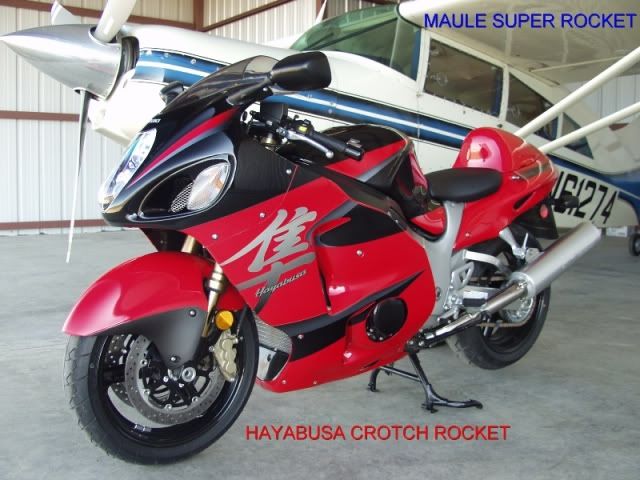

      A lot of good information regarding high strength chains and quality chain lubes can be found on the various motorcycle forums. The Hayabusa that I owned in a former life had an O-ring type chain that reduced the required frequency of lubrication. I never found a chain lube that would stay on at 200 mph though
