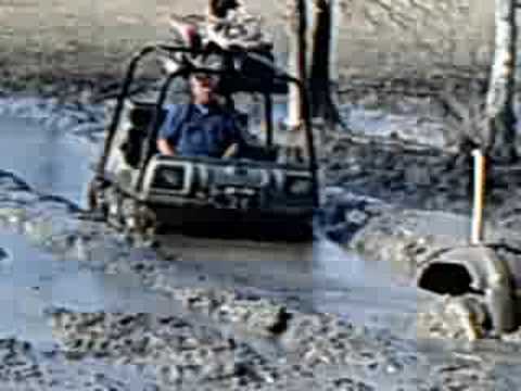

If you want the absolute set up put on a set of 22" Runamucks on the machine and add a set of Adair Tracks. I have witnessed first hand the absolutely awesome mudding ability of a Bigfoot with this set up. I have also seen this set up swim and would guess about 1 1/2 MPH water speed. There are several videos of this machine posted but here is just one.
I watched this Bigfoot run through every mud hole and swamp area we could find at river run and never saw this machine come close to getting stuck. The driver in this video is Robert who bought this machine after this track equipped Bigfoot pulled his Argo Bigfoot out of the Mud several times in one day.
