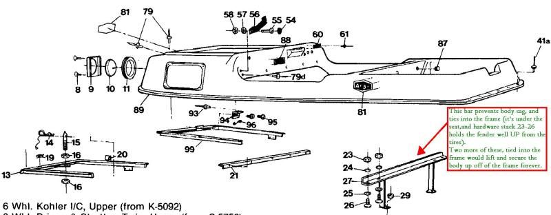

    I swear I have read about this on here. Is this the right way to fix the sagging body problem

    look through my thread in the argo section.i used aluminum checker plate to beef up the body and it still allows for body twist.

        I know one guy that pulled his tires off, propped the machine up off the ground from under the fenders, then heated the plastic. The weight of the machine was enough to push the fenders back up into place. Once it cooled it was fine.
        He might have added weight to the back of the machine, I don't recall for sure.
          I have sure thought that too. I was thinking to brace it with an underbend, bolt it with a bit of tension on it, and then heat it afterwards to achieve this. Did you get my PM, RD?
