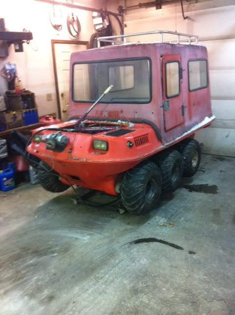

    My 90 magnum is finally in for organ transplant surgery. My friendly neighborhood argo service rep/max dealer has her scheduled for a bandolero. There will be parts requests, there will be discussion. Stay tuned...

            Well, I it's gonna be a lot of work in a little while, but I hope you can find to test drive that bugger on tracks before I get home! I might need you to do some measuring, I am considering just upholstering the entire inside of both cabs (nylon foam sandwich)
              aaron what is that black square looking thing on the lower tub front end? also when do you get back and are you done over there?
                The black square is where I am mounting the 20mm machine gun. Ok, so the plan is to have this rig (and another one) cabbed and tracked for moose and caribou hunting in Feb, when i get back. So, here is the muffler my argo man is suggesting, it is from Tulsa Engine Warehouse

                Trevor, ok, so its not for a machine gun, previous owner just thought that would make it easier to change the oil.....ya...awesome work, man.

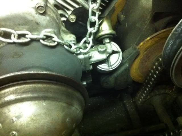

                    I think that Bando might spoil us both. Here is is going in
                    Parts list to date (needed)
                    A 23hp briggs oil filter relocator, that looks tight
                    A left brake caliper
                    A center outlet muffler
                    also looking for IN Alaska, a left headlight to fit a 97 conquest, and an older argo fuel tank
