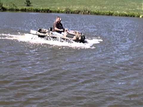

The Adair tracks swim well, which is saying a lot 'cause the others don't swim at all. It has to do with the open design of the track, it allows the water to drop through the track instead of carrying it forward and throwing it in front of the machine. If you spin the tracks too fast, they will throw the water forward, it's very noticeable both visually and as a drop in speed. A nice calm 1/2 to 3/4 throttle works best for me. Also, "leaning" to turn works better than "breaking" one side. I have some vid of me swimming, but have not posted it ( it's kinda like watching paint dry)
