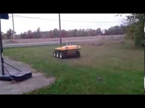

          Ok ran into problems. The 10 HP tecumseh couldnt keep a good idle. Its a stupid epa non adjustable carb. I tore it apart and cleaned it and ran the same. Runs great at anything more then an idle. So I yanked her out and going to find an older carb for it some day. Today I ground that engine mount apart and welded on a new plate for mounting motors. Drilled some holes for a 13hp honda. It sure is a smooth quite running motor. Probably should have dont that anyways. Its sits a tad higher with the aircleaner, muffler and tank like they are. The base of motor is probably a tad more then an inch from the frames lower part of the channels thats basically sits on the plastic. So its low, guessing about 1 1/2" from bottom. And it just so happen that with belt lined up the motor seemed perfectly centered. Look at valve cover bolt and hitch in one of the pictures. I ran it around a bit with no throttle cable. I have the wrong clutch on it so it dont top out that fast. The clutch needs a wider belt. But it seems like it will do the job nicely. Another bonus is Little LarryW can start this one with the rope.

                I didnt really do much to it today. I adjusted trans and put a metal plate on back so I dont melt the tub from the exhaust. I did run it around. I still need a throttle cable hooked up. But with a fixed throttle I can up it a little from an idle and let my youngest learn to drive it without him going to fast. He has drove an Argo 8x8 with handlebars and spent a little time on a MaxIV but couldnt really give it any gas because the throttle was to hard for him. He was also having a hard time pulling the sticks back with them being spring loaded. So today was his first Attex run. He learned the stick controls well.
                  HAHA he is on top of the world ....big smiles .
                  Good Dad
