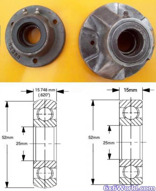

            I'm not sure the numbers patb gave you are correct for a st300, does your machine have aluminum flanges with 2 bearings on the outside of the body?
              I'm not sure.how do I tell?that would be my luck...

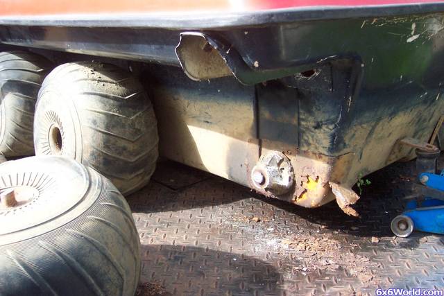

                First picture from larryw, second what it looks like on my machine after I had to cut the axle.
                  It's the second one...What's that?
                    The second one is the later early style housing, the picture shows the measurements for the bearing. You could try to contact member larryw or don for an actual number.
                    You also could redrill the frame to accept 4 hole flanges and go with the later bearings patb listed, provided you buy new flanges.
