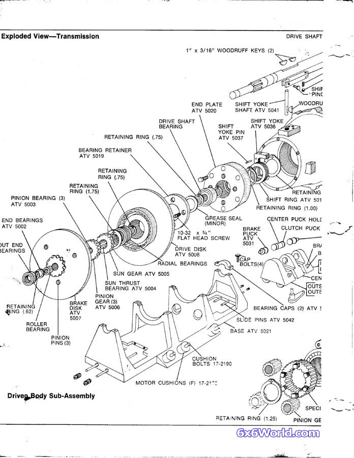

            I found out anything that you can get running is a steal... Rebuilt the old carb on the original engine and got it running. The only problem is it doesn't steer. UGH!!! Found out this is a 69 or 70 attex. I ordered new brake pucks and will put those in as soon as they come in the mail, then out for another test run. Was told not to fix it by the guys on the other website. Don't know if I should believe them. I feel all old toys need a chance to come back to life. And its a neat toy.
              It's absolutely worth a shot to get it going. There's a manual for the first generation machines posted on this site and it has a blow-up drawing of the Baker/Hill transmission. If you need any help with it there are a few of us on the site that still tinker with the old transmissions. Good luck with the old machine; post some pictures.
                Hey Old Yellow,
                Here are a couple links to pictures of the exploded view of the Baker/Hill that Don's referencing...
                The entire Attex FSM is located here, toward the bottom of the page... http://www.6x6world.com/forums/conte...r-manuals.html
