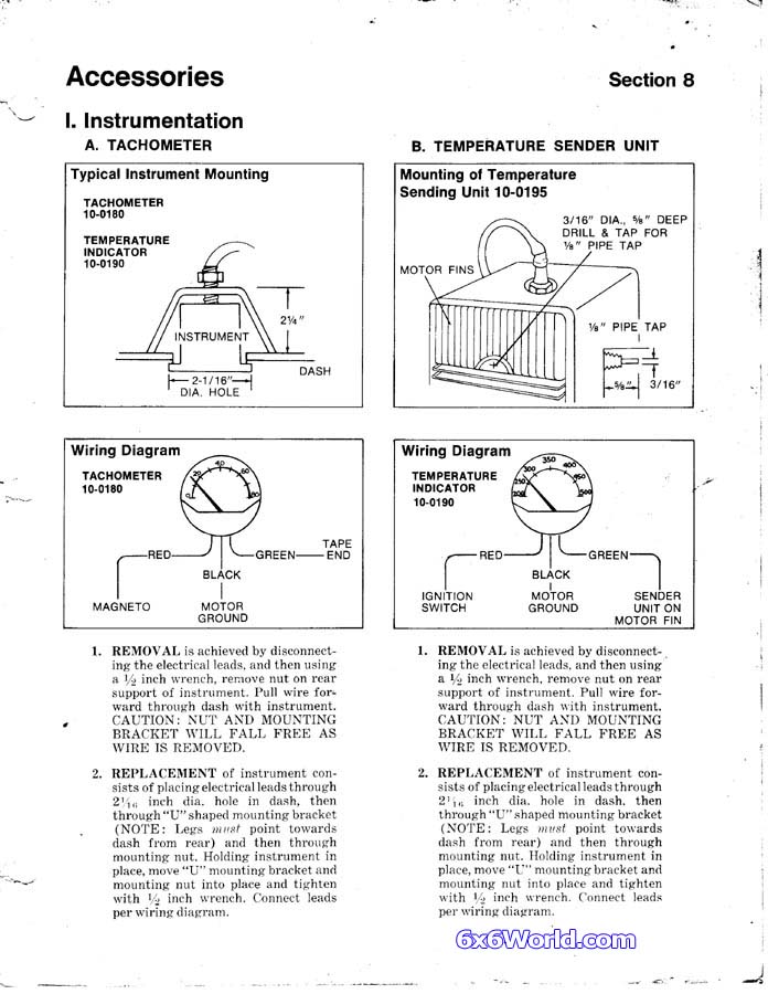

Still need to figure out how to add a RPM and speedometer gauge i hate the digital stuff....

This might help for the gauges. http://www.6x6world.com/images/attex...-manual-69.jpg
