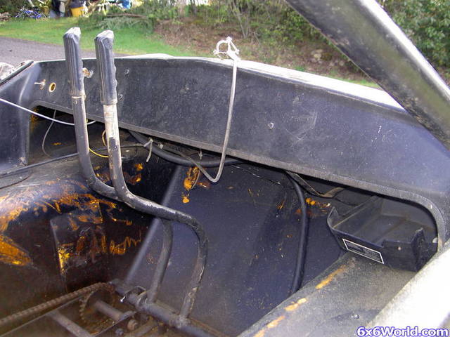

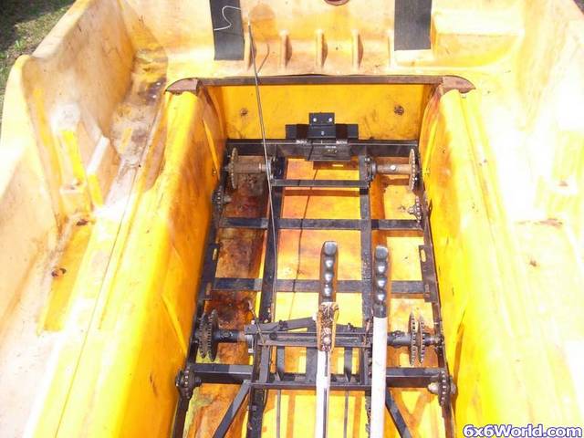

Hi Danth,Originally posted by Danth View PostWhere's the board? Would someone please take a picture of the linkage from the transmission to the operator compartment on an early 297 thanks dan.
Here are a couple shots that Adam in Va. has in his gallery of the linkage from the transmission to the foot well (passenger compartment) on a 297.
As you can see, it's pretty rudimentary and little more than a piece of flat stock with a hand-hold on the end that passed through a hole in the foot well. Pull forward for forward and push backward for reverse. The original air filter element on the Tillotson-equipped JLOs was little more than a mesh screen, much like snow machines of the time used. If you plan on extended use in dry conditions, I would try to upgrade to some sort of modern oiled-foam element to protect the engine better. Just to be clear, the original "filter" is missing in the pictures above.

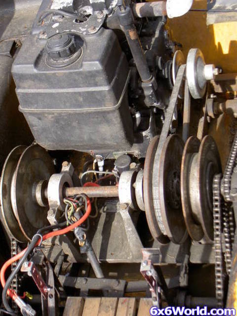

::EDIT:: found a shot of the original filter screen setup WITH the shift linkage. Boom.
