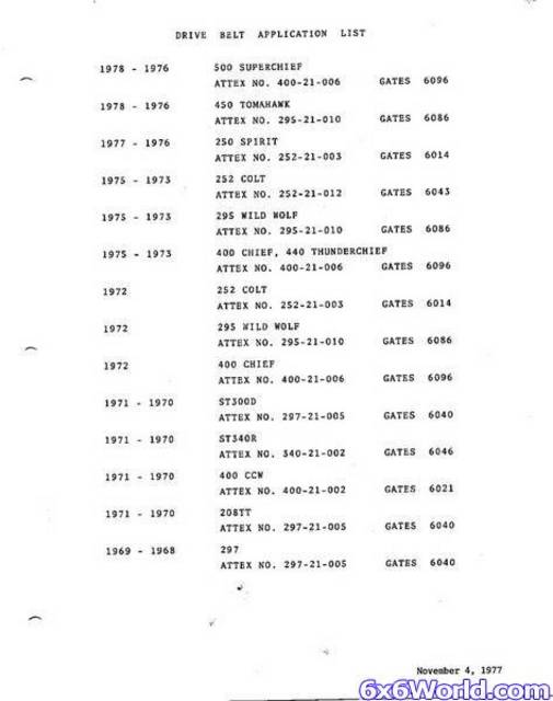

Umm ok, that is the only size not listed on the chart, all the other machines are 1 3/16" wide, but they are also post-Baker hill, so you'de be best searching the part number more, everyone with a 72 and on Attex machine, or anything else with a Gates part #, you can get exact sizing at this site:
Attex Super Chief - Sold.
Yes, 6040 is the only number on the chart you posted not listed, and I searched the Gates Mfr website, and nothing on that number. Must be long-discontinued. I posted it up when I found it, then tried searching that particular belt, only to find it missing. Thanks Larry, though, I now know the correct size for my W.W. and Colt now.
