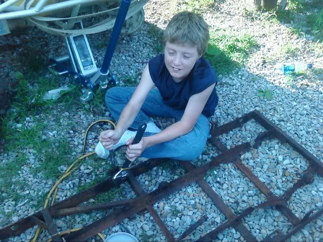

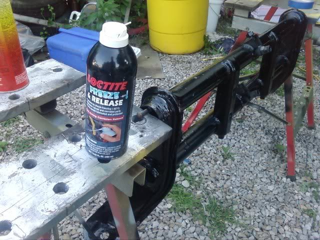

This Loctite Freeze and release seems to work good, always was a PB Blaster guy, but this stuff seams to have its place on the shelf. My friendly local Grainger sales rep hooked me up with a couple of sample cans.
Even got the local kids to help with the Attex.

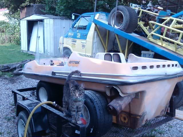

I cant help but think I want to do a camo paint job on the thing, My main purpous for wanting it is for hunting and I think as a duck blind Yellow is not the best choice. Thinking a 2 tone brown. Besides I think when I get done fixing all the cracks it wont be all yellow any more.Cave Trolls Rule!

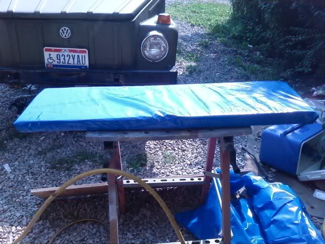

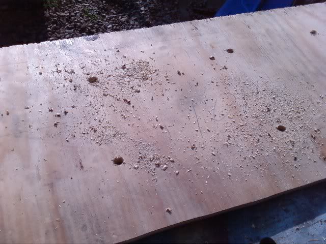

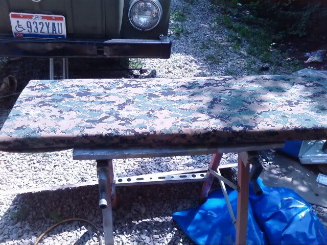

Started on the seats, used some foam I had at work, some scrap plywood, and some plastic sheeting I use to Shrinkwrap boats, and some fabric I had for redoing the interior of my Baja Bug.
Does this look right? Or do the bottom corners need something done?
That fabric is what USMC uniforms are made of
Sprayed some waterproofer on it too.Cave Trolls Rule!
