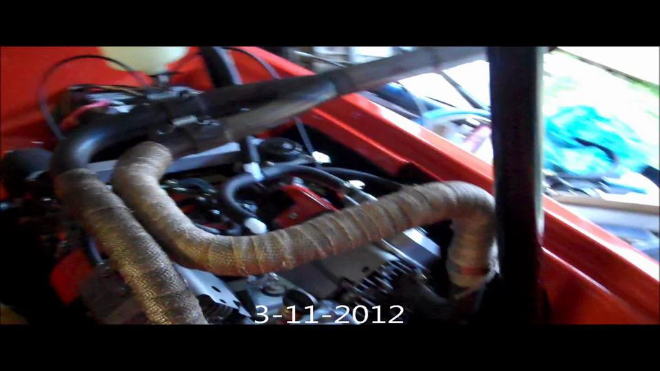

Slowly but with steady resolve i am making progress with the Crush. I have had a bugger of a time with the throttle make-up to go from a single carb to twins. Evidently they went the way of the dinosaur also.
Still have a little work there but it is next on the punch list to finish. Splitters are hard to come by these days and member Don helped me find another one on line. Thanks again Don. Sent the whole thing out to have another one made and they can't make a copy, they don't have this and they don't have that. So i just told them to send it back. Professionals
. So i have more cable coming and i will make it myself.
Had to do mods to the motor cover to keep the air flow where it will cool down the engine as designed has been fun. Rerouting this and that has been through several changes but it has been a blast. The Mikunis i used have a side throttle unlike the traditional Mikunis, so this is where the challenge began.
Obtaining the right throw distance has been fun. Cut down the handle about 18 degrees to make it all work. Posted up a few pictures as to the progress. Have learned a lot about the construction of throttles in the past few months.
