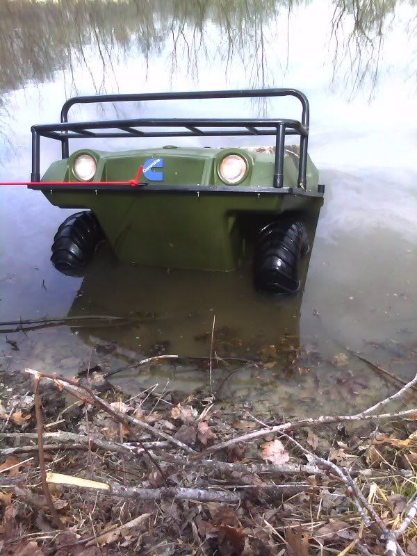

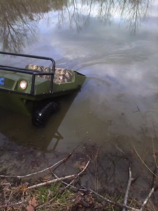

I got a wild wolf with a shot motor and i have a 3 cylinder diesel i intend to put in it i figured id start a build thread.
the motor is going to be to tall for the stock cover i plan on building a new seat and cover with a cargo rack.
checking the fitment of the motor
i plan to use the red piece that used to mount the generator to the motor to hook a gear and chain to the input of the t-20. Since the diesel has a lot more torque but only revs to 3600 rpm im going to use a larger gear on the motor then on the input of the t-20 to speed it up a little.
