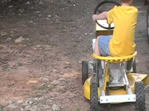

Jimmy had a bit of brain fade at the controls and punched a hole in the LR corner of the tank with the pimpfoots front bumper. He felt absolutly terribly, but I assured him that it could be fixed (already is). I swam the machine for the first time and it did pretty well. took on some water but that is what the bilge is for. I did have some issues with the engine once it got hot, but I think the fuel was trying to boil in the line. (relocated the pump and wrapped the lines to keep radiant heat away) The engine cover also got hot enough to sag till the exhaust duct rubbed on the primary clutch. We got home from the ride to find the choke cable and header wrap sitting on the front porch.
