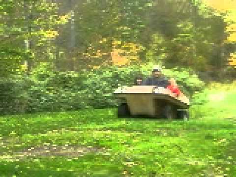

My husband says its faster, but either way.
but atleast we know it runs and drives
