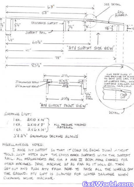

                  this is a support I found on here a long time ago. It works well.
