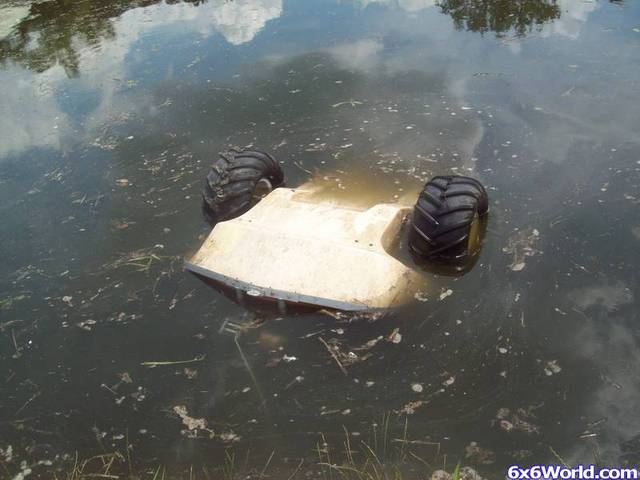

This image shows a machine with water even on the outside and inside of the machine, every move made caused more water to enter and nearly going down, luckily this water was not that deep, a bilge pump and a team effort safely removed them and the machine from the water. There were a multitude of contributing factors that occurred simultaneously which led to this.
A quick sorry to Jim and Sam, but somebody's gotta learn em.sigpic
Many thanks to ARGOJIM....I have been treading lightly around this subject and finally have to break free and state the facts. The MFG lists a GROSS PERMISSIBLE WEIGHT IN WATER for a very specific reason. Your AATV is a water vessel and your "vessel" displaces water. It displaces water in weight equal to the vessel weight. As you add more weight to your "vessel" and try to float it, it will displace more water up to that added weight, continuing up to the time that you have exceeded the gross permissible weight and water begins to seep into vessel openings such as seams, engine openings, or other openings in the body hull. In the two photos that argojim posted, both "vessels" luckily went down in shallow water. However, what are you going to do when you have a problem in much deeper water? I have seen hull opening much larger than most bilge pumps will handle! Folks, bilge pumps are designed to handle minor leaks, not to refloat the Titanic!
