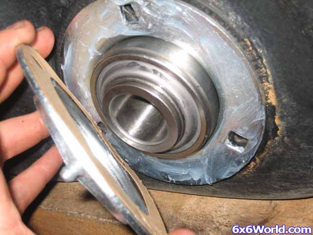

It's been raining here so I thought I would take that as an opportunity to do a little maintenance, since I couldn't ride anyhow. Iv'e been noticing that my 950 was leaking for some time now. So one of the last rides that I took I left the floorboards at home and went to the creek to see if I could find the source. Now keep in mind that I had already tried the old fill 'er up trick and although it did seep from all but one axle, the fill rate while riding seemed roughly equal to the fill rate of the hose going full open into the tub. So upon driving into the creek I killed the engine (don't worry I wasn't in deep enough to float) and listened to the sound of trickling water. Yup you read right I could actually HEAR it pouring into the tub. So I knew I had a problem.
Fast forward to what I found on teardown. RTV to hdpe BAD! reuse old rubber gaskets BAD! water in bearings BAD! Loose inner bearing setscrews BAD! no loctite on outer flange bolts BAD!
Decided to do a little test : It has been my experience that most bearings can be repacked with grease if you are careful to not damage the seals upon disassembly. All my outer bearngs had some spreading in the seals. So I figured what the heck and popped the little metal ring off the outside only to find that it was only that, a metal ring to protect the actual seal which is no different from your average sealed bearing seal- rubber ring around the inner and outer circumference of a thin ring of metal , which resembles a really thin washer. So I cleaned the crud out with solvent and compressed air and packed it ful of lucas red and tacky and put it all back together.
Now the real surprise was this: I grease my machine after every weekend's riding. Usually on Sunday or Monday evening OK I'll admit it I have even been known to skip it until Friday morning before I head to the swamp for my solo trail work ride. But what I'm saying is that the 950 gets greased every week, up on blocks, tires off, in gear, with the axles rolling to be sure the grease goes where it is needed. WRONG! I must state that I was QUITE dismayed to see VERY little grease in the bearings when I disassembled them. But there did not seem to be much mud in them either which also came as a surprise.
From now on the torque wrench gets used and loctite goes on everything!
Did I over grease them and blow the seals? Don't think so, remember The loose setscrews and flange bolts I mentioned well those combined together with the normal stresses of riding conspired to loosen the seals at the bearings which left to themselves would have had me buying new bearings pretty soon I think. So, if you think that you are greasing your bearings enough then you might want to think about all this and pull one from time to time just to be sure.
Oh yeah and those rubber gaskets, well they are gonna go for a ride on the garbage truck soon. Seems like Auto Zone sells some stuff called Ribbon Sealer It's used to replace auto glass and has an ingredient list that is very similar to the 3M strip caulk that Recreatives sends with their bearings as a replacement for the junky rubber gaskets. I will let you all know as to how all this works. Think I might even TRY to blow A seal on one of the bearings just to see how much it takes. I mean since Iv'e got it torn down anyway and it's only a matter of pushing the seals back in....
