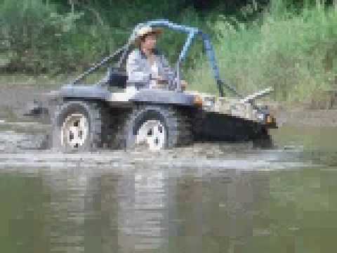

          I think you should talk with forum member BW6 who has a set of 6-30" mud lights on his Bush WackerII. Out performs every other 6x6 in mud, swims about 2 mph, but those big tires twist axles and play He_ _ on wheel bearings. Ask him to post a picture . Here is video of his machine.

                Robert, there are any number of things you can do to put bigger tires on an AATV, but take it from someone who had tried several combinations-going larger than 26" is more trouble than it's worth. The tires are hard to turn in the mud and cause axle and bearing problems. I currently have a set of 26x12x13 ASX Vampires on my max and this is about as tall as I want to get. I have several videos posted on the forum and You tube if you want to see how they perform. At one time i had a set of 27x12x12 Swamp Fox plus tires on my max and i have several videos posted of the max with these tires. They were a good combination-but gotta take the good with the bad. For now I will stay with the 26" ASX.
